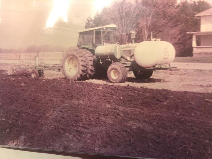

1970... my dad in the 5020 pulling 8x16's. Anyhydrous ammonia going down to feed the years corn crop.

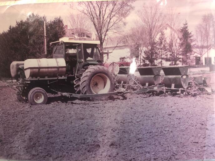

Planting 1970 style. Still have the 4020, drove it today.

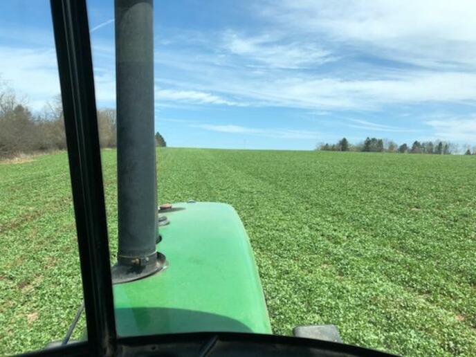

Planting this spring... no plow, no disk- one pass with the planter into alfalfa sod. John Deere 4455 on a 7200 6 row planter. Despite a smaller planter and much more acreage, it's easier to get done in a timely fashion when you are only making one pass.

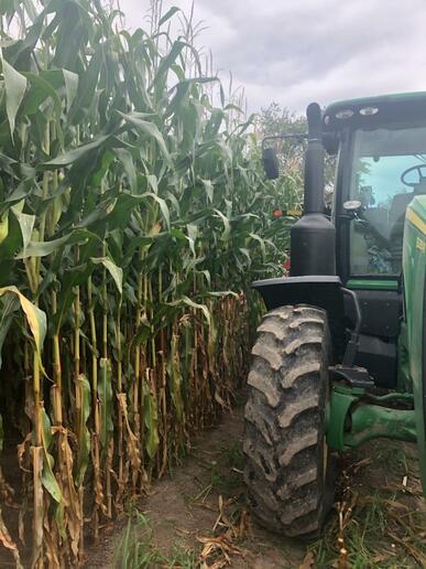

A healthy crop. Not the best we've grown, but a decent crop of silage corn, no-till planted into alfalfa. Only 10 lbs of commercial N fertilizer applied as starter, the rest came from the previous crop of alfalfa and an application of manure the year before.
