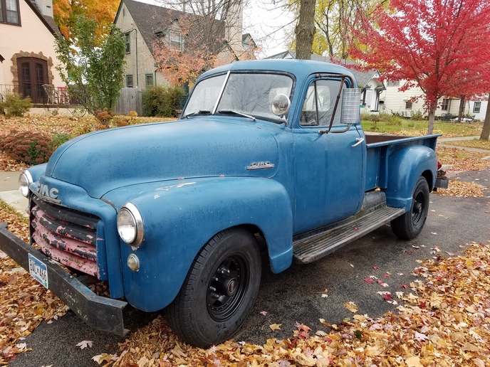

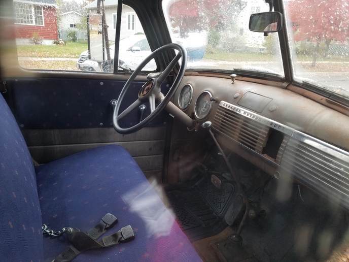

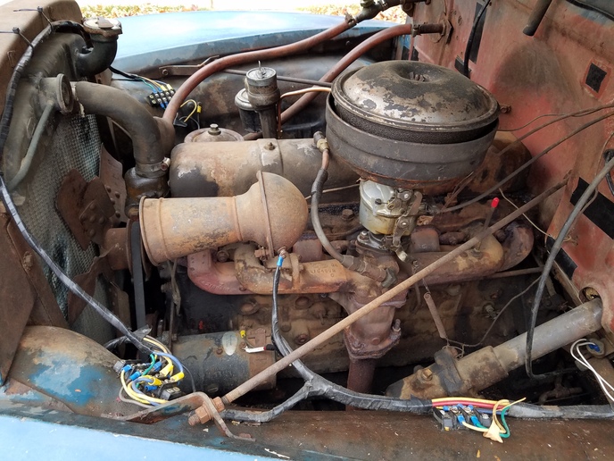

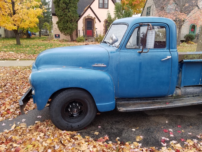

Purchased in 1982 in Flagstaff, I bought it sight unseen for $100.00 I have done nothing but a water pump to the engine in the years I have owned it. it has 75000 miles or so It has never seen salt. The engine is a 270 CID high deck. full oil pressure, and holds it at 35 when fully warmed up. It has never seen salt. The widow maker 17 front wheels, and split rimmed 17 rear are gone. I could not find good split rims to replace the fronts, and all the tires were 50 years old or older. So new 10 ply rated 16" on American Racing (one ton rated) aluminum wheels. The trans is 4 speed, and it is a heavy 3/4 ton. I replaced the bushing in the steering kingpins with needle bearings on SAE 4142 QT steel king pins I fabricated. New brakes and brake hydraulics, and rewired with Plus one wiring and 8 plug style fuses in fuse blocks. It has been driven all across the western USA. I am not selling it ever, and neither will my son.
