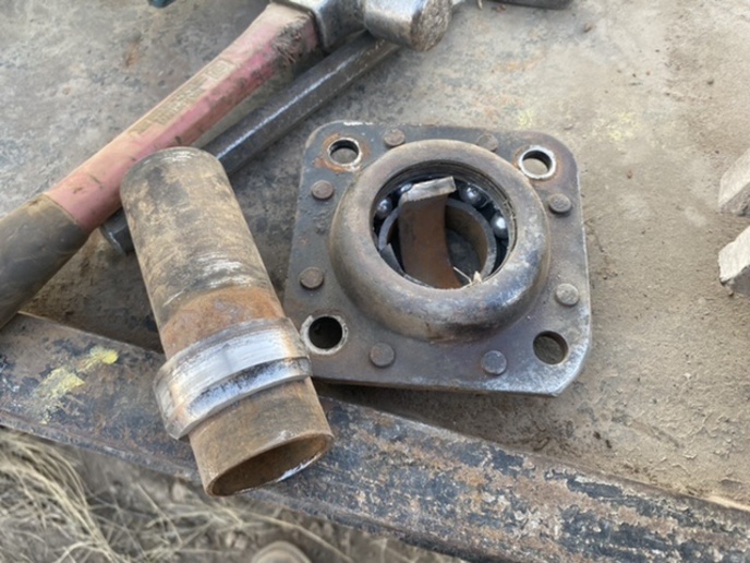

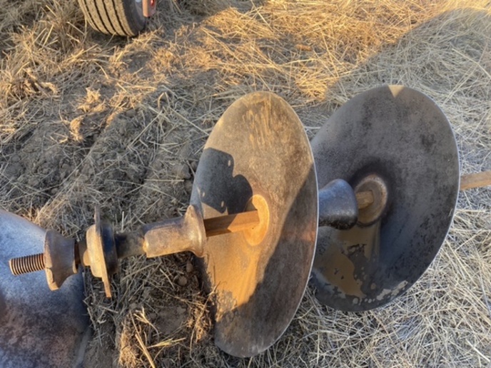

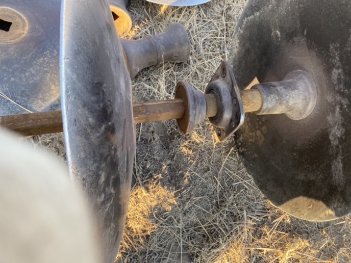

Started going back together only of the pipe spacers would come out of the bearing going to have to torch the bearings in half to get the other two apart

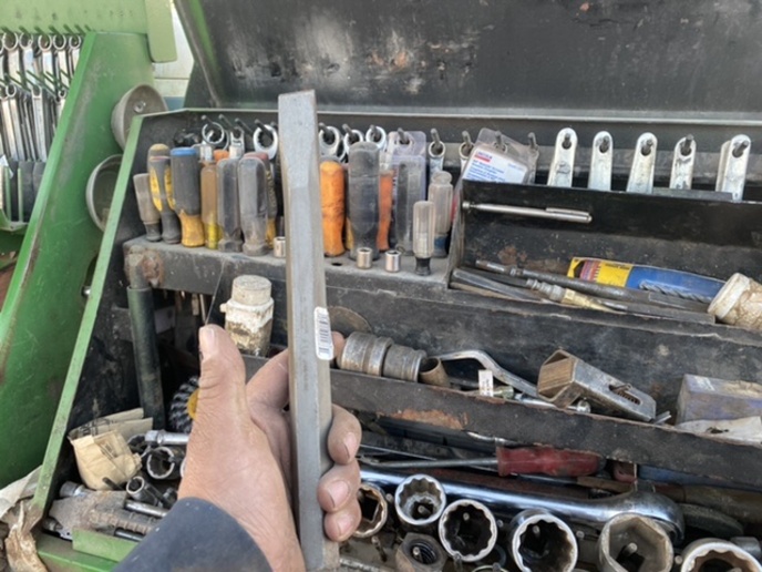

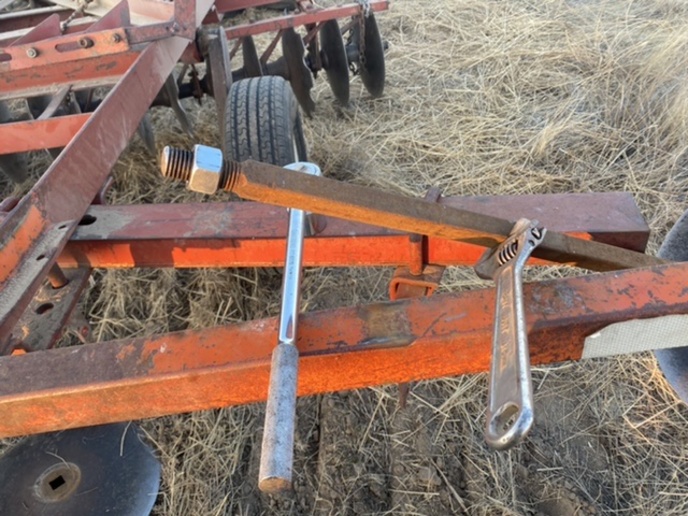

Had to dress the threads up for the nut i was able to clean them up enough to get the nut off with my die grinder but it took a little 3 cornred file work to get the new nut to thread back on
