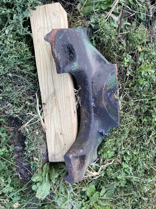

got a look at the old casting that gave way on the steering. from the looks of it id say metal fatigue. looks like part of it was cracked for some time before she finally let go. i wonder if the was a problem with them as the replacemt part took a while to locate. heres pics
