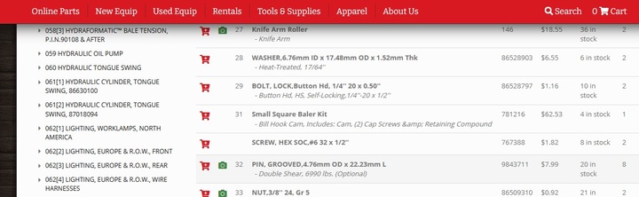

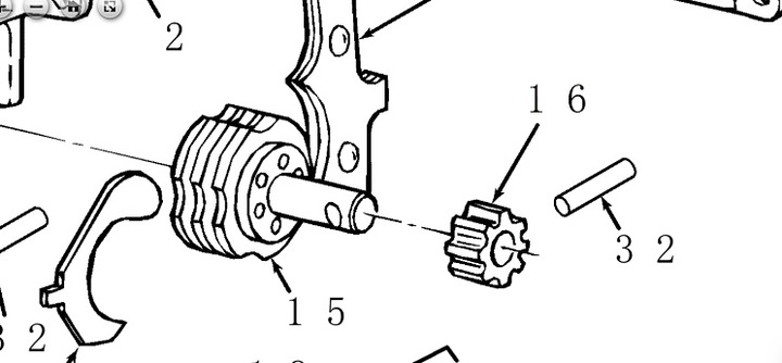

Look up a 570 baler. It shows that same #16 gear but also shows the groove pin #32 part #9843711 $7.99
