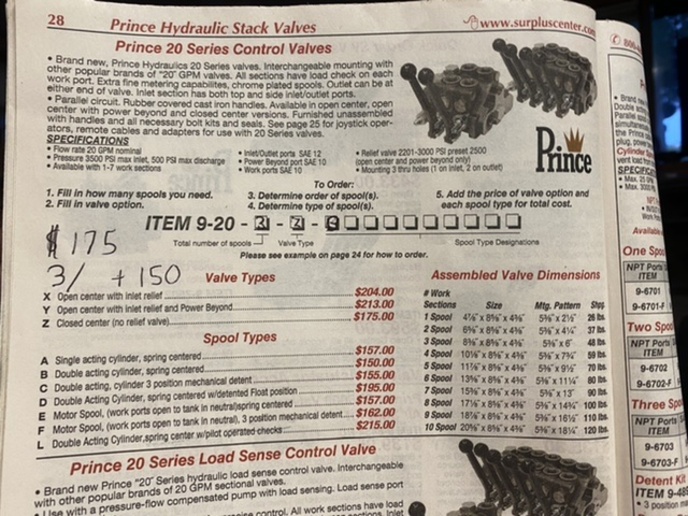

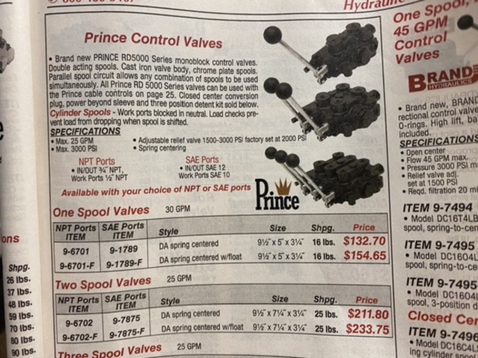

Closed center hydraulic valve
Posted by svcummins on August 18, 2020 at 19:20:54 from (174.27.208.161):
Why is one of these three spool valves almost 700$ and one
less than 350$ ? Will they both do the same job look like they
are rated the same? Both have load checks.
