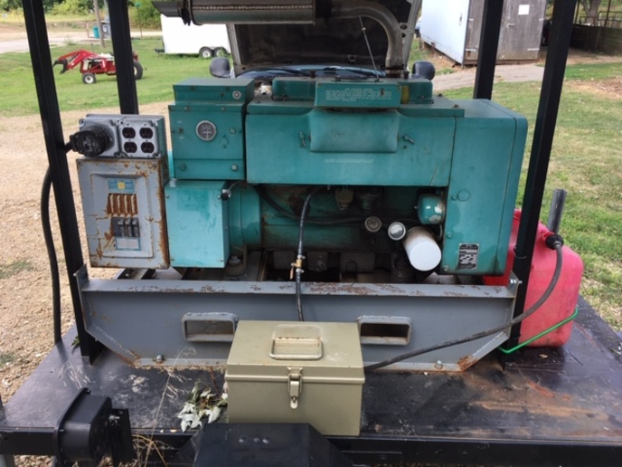

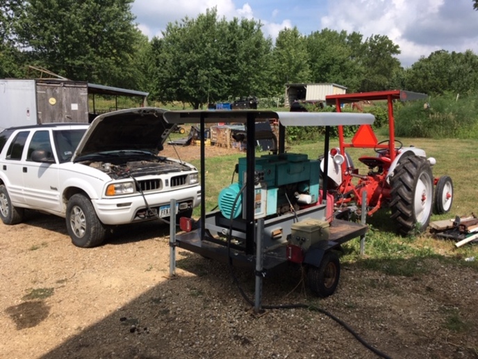

Got my old Onan out to run the shop so I can fix a few things. I think its a model JC I can't remember. I hadn't started it since last fall, and it hasn't ran more than a hour at a time in the past few years. Stuck the fuel hose in a fresh tank of gas and jumped it off the car and she fired right up. After being on a load for a few minutes I checked the voltage, it was a bit high at 128v. There are two pots on the control board, I tweaked one a bit and the open circuit voltage came down to 121v and with a fair load on it is 116v. Cycles are 61-62 but that might be my meter. It is a cheap digital. Power company says we'll be out for another 3-4 days so it will get some run time.
