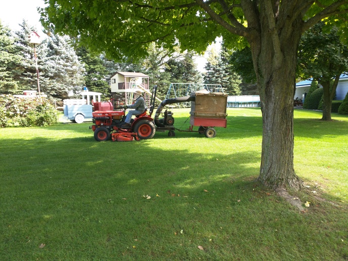

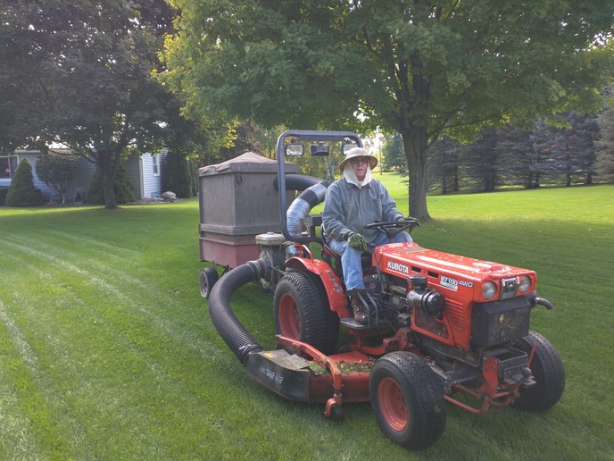

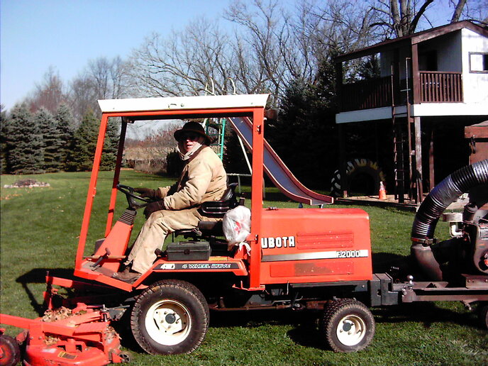

When I had my collection system on my front deck machine (sorry, picture doesn't show the pipe), I used a 5' piece of 6" vent pipe attached to the deck adapter and I also use 6" corrugated solid plastic for pipe instead of the flexible hose. I don't have all those sags and it bends enough to turn as tight as the tractor will turn.. This is a picture of it on my current tractor. I built this unit from stuff I had laying around 35 years ago. The only real expense was the fittings and quick clamps used to attach the piping to the blower. I can remove the pipes in seconds to clear clogs or dump.
