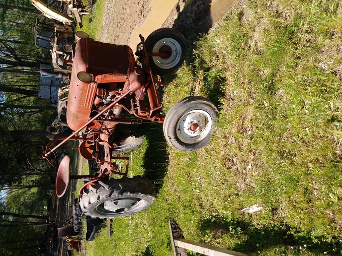

Bought a '49 cub from Tracy Brown a while back. All 8 valves were stuck. Got that fixed. Someone put an external coil on the magneto and did a terrible hack job. It wouldn't produce spark. Picked up a magneto from 1sarge in MS but it didn't snap over good. Yesterday my wife and I took the good parts off the "new" mag and put then in the one that came on tractor. We have spark! Nice blue- white spark will jump 1/2 inch off coil wire. Gotta time the tractor now. And get new plug wires. Looks like something chewed up the old ones. This tractor will live again! Did you know that a mag will bite you? Lol. My wife thought it was funny!
