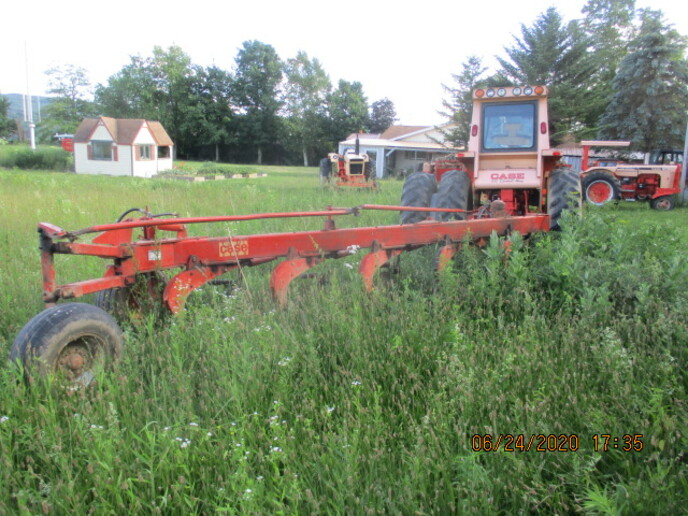

You are already a winner. That loader is worth twice as much much as you have invested. It easily mounts to many brands and models of tractors without having to buy expensive specialty mounts, A piece of 8" channel iron to bolt across the front bolster of most tractors, and some angle iron for clamps around rear axles and you are in business.
The physical appearance of the tractor appears excellent. We have parts suppliers/friends, on the CASE DB forum who can supply quality parts at very reasonable prices.
Rebuilding the engine would be a no brainer for me. I installed 1/8" over sleeves and pistons in mine and redid the heads. The engine is now 426cu.in. and pulls like a bull. It has plowed about 600A pulling a 5x18 plow
