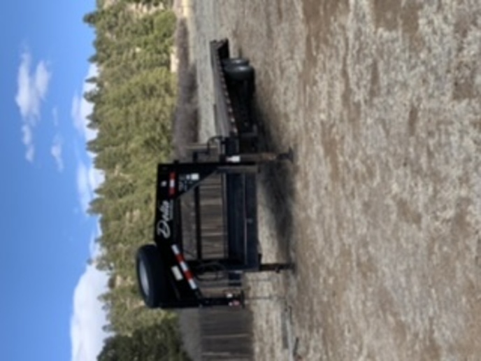

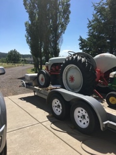

If I�m hauling on of my 8N�s I use this trailer with 5/16� Gr.70 transport
chain with pull over binders. If I�m hauling the J/D 5203 I use 3/8�
Gr.70 transport chain with ratchet binders. Sorry about the sideways
photo, picked the wrong one. Straps only when I haul my little J/D
Lawn tractor.
