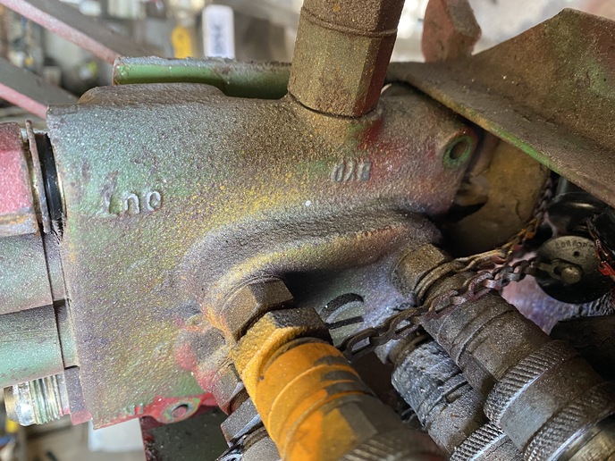

You most likely never heard of tractor but hear goes. Tractor CAST, loader KUCHYT, Distributor RECO Sales. Here is what I'm trying to do. Tractor had a 4.5 GPM pump. Distrbutor put Hydrostatic steering and loader on tractor.The pump is to small. I'm putting a larger pump for loader and using the 4.5 GPM pump on steering only. Plumbed like this. oil tank to 4.5GPM pump. Pump to steering unit, sterring unit to oil tank. Oil tank to larger pump, larder loader pump to loader valve (IN).loader valve (out) to oil tank. loader valve BYD port to ????????.
