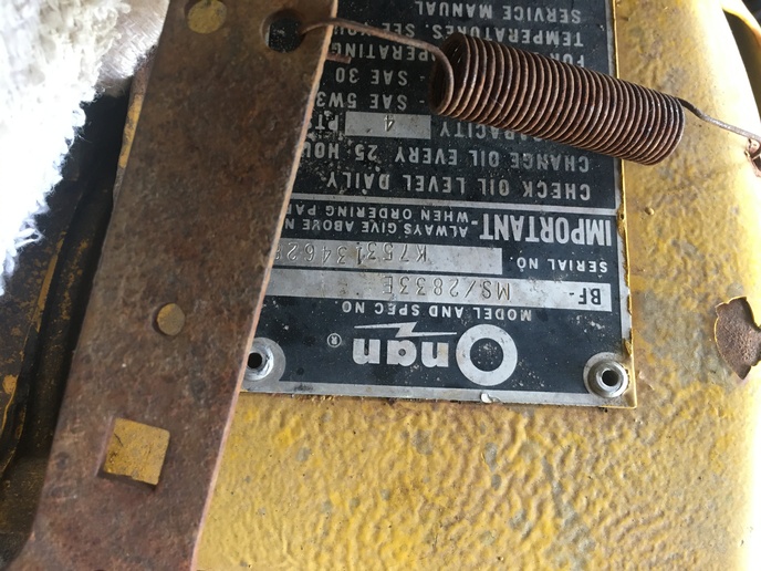

Good Morning. I have a 16HP Onan in a Rounder L600 Skid loader. The carburetor float is done and I cannot find the replacement using the numbers I have. Engine model is BF-MS/2833E, serial number is

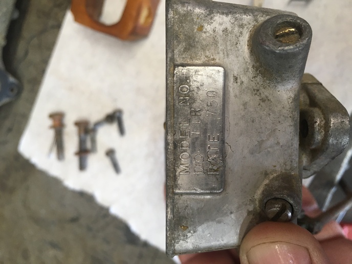

K753134628. Carburetor model looks to be DD 11R. From the Rounder parts manual, the float part number is 50002741.
In the searches, I have found a 0146-0380 float, but that doesn't look like the OEM one I have, and just want to make sure before I order one.
Thanks for your help.
