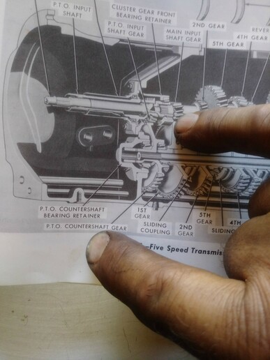

About 5 hours of run time ago the
transmission started making a rattle
noise. Started out just a little noise
when you let clutch out. Then while
cutting with sickle mower on Saturday it
got to be almost all the time while pto
was engaged. Took gear shift plate off we
were able to determine the noise is
coming from the front of the
transmission. You can hear the rattle at
the end of video. I guess we gonna spit
it at some point. Took the swinging draw
bar off and put it on 640. Got hay cut.
Gotta bale it.
I guess I could run it a while
more......just no telling how long it
will last.
