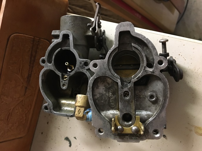

Hi, I tore apart my zenith carb (12225). This thing was pretty nasty inside, especially with what appeared to be uncured or reacted RTV that was used to seal
it. Attached photos are of it cleaned up a bit (still a ways to go).
The float appears to have gas in the pontoons (which explains some issues i had with the tractor pointed up hill) so i plan to replace that.
I've got a rebuild kit from YT, but it doesn't contain the two little jets in the castings. Also whoever rebuilt this stripped them pretty badly. I'm planning
to drill out, remove, and replace-- but i cannot find these in any of the rebuild kits anywhere.
Anyone know what PN these little jets are? And where i can find them?
