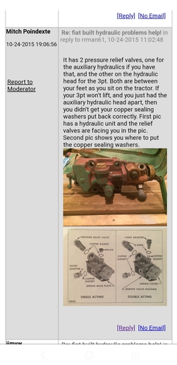

Question 1: Would the 3 point hydraulic relief valve
(located on the hydraulic head between your
calve muscles/legs while on the seat) cause
the hydraulic lines to be noisy if the
copper washer was missing or to thin. While lifting the 3 point arms.
