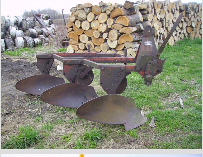

Assembled wrong, should be on the right of center, and remember, the right tire rides in the ditch of the last pass, so your first pass won�t be very good until the second pass when the tire �drops�into the ditch.
