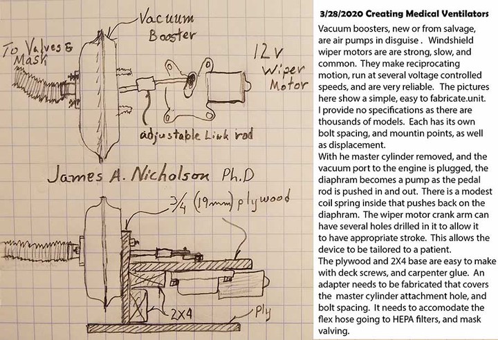

I post this to share it with who ever cares. I believe it could be a solid way to create a good pulsating air supply for Corona Victims that need it. There are thousands of used vehicles in salvage yards, and new in the supply chain. Wiper motors are very reliable, and also modest in amp draw. No internal changes are needed, the control valve can remain compressed as though the pedal was pushed a bit. I will supply this to The Star tribune in hopes they run it, but feel free to send it to your paper as well. The issue is critical, and this solution is not beyond our ability.
Jim
