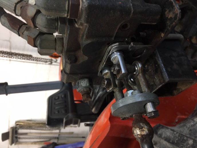

So the neighbor needed some work done on his loader tractor. When I brought it home I noticed that there was a lot of lost motion in the lever that operates the loader valve. It is a Bush hog loader with a Danfoss two spool valve. It uses only one lever to control both spools. The lever bracket itself is held onto the valve body by two small allen head bolts. One was gone and the other was loose. All of the other allen head bolts were loose as well. That made the for a lot of wear in the holes the bolts went through. After I found enough good bolts to put it back together, it doesn't work as good. So I went on line and found a parts diagram. Think I know what I need to change to free it up. Any of you guys worked on these?
