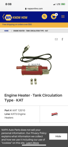

Get one of these and you will have a warm engine to start. They work better than block heaters because they circulate the heat, also better than hose heaters because the thermostats don't stop flow. The instructions for plumbing come with. Get a big one and it will only take a couple hours to heat your engine, the small ones should be plugged in over night.
