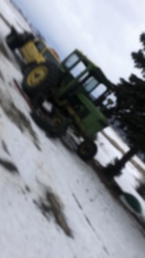

Finished another project
Posted by SVcummins on December 28, 2019 at 22:02:22 from (174.27.144.234):
Neighbor brought his 4020 by to have me seal up some hydraulic leaks . I replaced the load control shaft bushings and seals and then found a steel line that the park lever on the transmission rubbed a hole in . Need new battery�s and it�s out the door .
