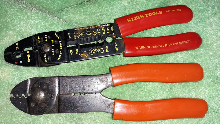

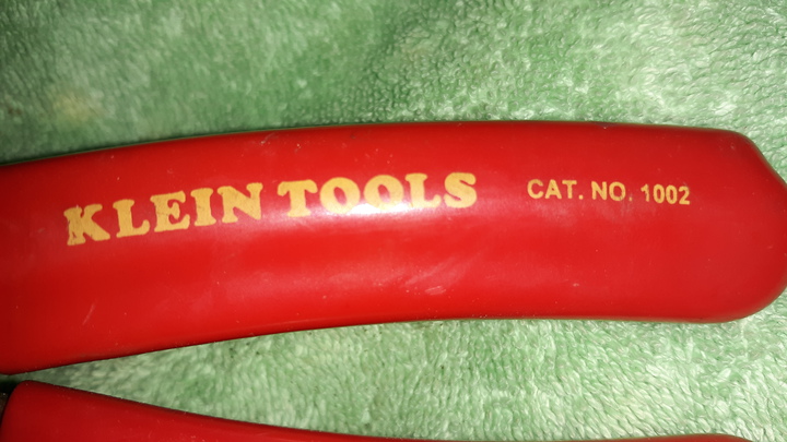

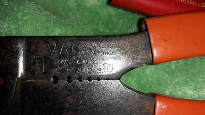

In all of my crimping it depends on the tools, fittings, and. Type of wire. If you are trying to crimp ontofine strand automotive wire the stuff can slip out. I take my soilder gun and tin the stripped ends. THEN when you crimp a fitting it will stay. Here are two of my tools and there is an even better type but they cost a lot more and don't own a pair. When making a splice use a linemans splice and then coat it with Weldwood contact cement. This stuff makes for a water tight seal. Then I double layer with heat shrink tubeing. Never had a corrosion problem.
