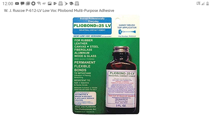

That is what the contact cement does. Was developed by Goodyear. Original name was Plyobond. Have been using the stuff for years. When you heat shrink it the stuff will skwish out the ends thus assuring a water proof seal. Beleave me, it is a real bear to try and remove. MEK is the only thing that will touch it.
