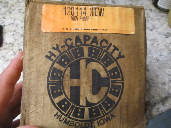

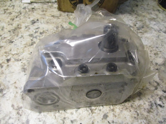

They have two pumps one the hitch pump that is working fine,, the MCV pump is what is losing prime,, oring or gasket bad,, may fix it with out changing the pump I see I still have a new one left from my repair shop days, I sold lots of these pumps int hose days,, always stocked two of these and a Hitch pump and the seal kit Hy Cap sold for them, down to a pump or two is all for IH now though
