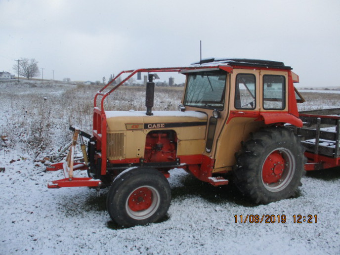

It is a small volume self contained system. CNH Hi-Tran which is recommended in the tranny and hydraulics will work and give you a common fluid through-out the tractor. Anything from ATF/PS fluid, to motor oil to the taboo 303 in yellow jug will work fine. I use universal HTF in my 440 after fixing the leaky steering cylinders.
