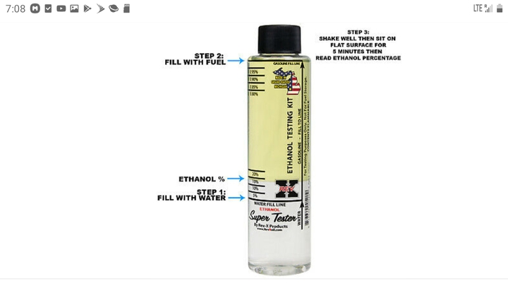

Not necessarily so. In NJ the hi-test at my station doesn't have ethanol. Some
stations do but it is 5% not 10 %. I run that little bottle with water test
with some food coloring. Shows you pretty quickly. I bought fuel from another
station and I think that is why my carb got ripped up. Will need to empty the
gas out of the leaf vacuum when I am done.
