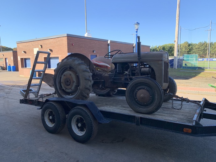

I am student teaching an agricultural mechanics class and as part of the class I am having the students rebuild a Ford 9N that was recently donated. As part of the project, we are tearing the engine apart and putting a rebuild kit into it as well as a 12 volt conversion kit.

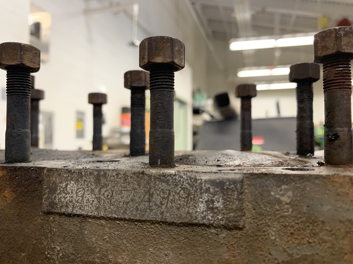

My main question is, is there any way to identify the size of the sleeves before you have them out of the engine? I am aware these tractors could take two different sleeve sizes depending on the year, .040 and .090. This being a Ford 9N it came factory with .040 sleeves, which means they could have been upgraded to .090. The serial number is *9N97499* and the shop manual states that the star (*) designates the .040 pistons. Based on this, as well as it being a one owner only tractor with reportedly low power last time it was run, it is believed that the engine is an original .040 sleeve size engine. A engine kit with .040 sleeves was ordered based on this.

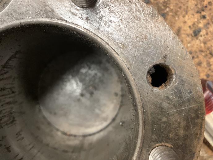

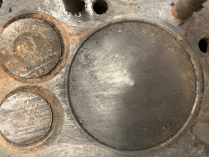

We just took the head off the engine today and one of the first things noticed was that the pistons are domed. From what I have found, some say this was a factory option, can anyone confirm? We are trying to determine if this engine has been rebuilt or not. The only thing that would suggest engine work is that the distributor has the "Reconditioned by Authorized Reconditioner" ribbon, though this could certainly have been done without any engine work being completed. The parts for the engined and electrical have already been ordered from Steiner due to the tight timeline needed and the time to process the order, so just trying to confirm before they are shipped so it can be changed if needed.
