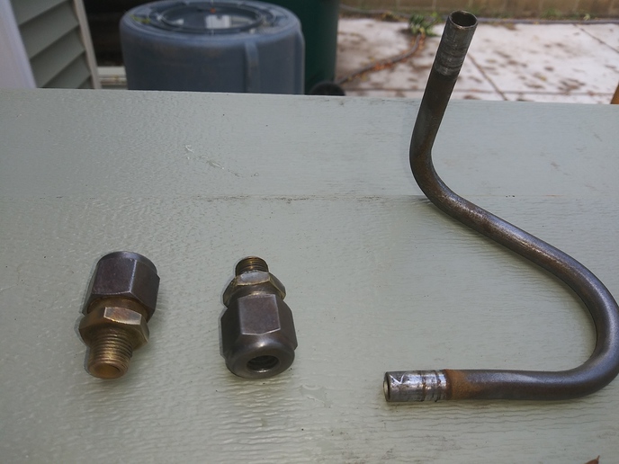

Those 3 cylunder gassers did take a rather circuitous route from the tank to the carb didn't they.
But those engines were first designed to be diesel and kind of as an afterthought made to run on gas. About the only place to put the fuel pump on them was on the timing cover so that's what they did.
I think the threads that go into the sediment bowl and into the carb are 1/8" NPT. The other end is like a compression fitting that uses a rubber ferrule inside the nut. About the only place I've ever seen them is on these Fords.
I do have a pair of those fittings here that I would give you free if you want to pay the shipping. Would throw in the correct inlet pipe that loops around the throttle and governor rods too if you wanted it. Same price.
The fittings would go in a $7.50 Flat Rate box. If you wanted the pipe too it would have to go into the next size larger box $12? $15?
