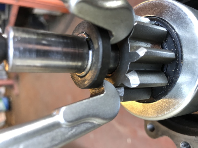

Starter drive replacement
Posted by ranchingelec on September 04, 2019 at 19:23:52 from (142.165.85.98):
I have installed a new starter drive on the armature. Now I have to get the circlip back together. What is the trick here? As you can see in my picture I have put a puller on the keeper to hold it against the ring then I tapped the ring with a brass punch to try and get the keeper over the ring but no go. What are your suggestions? The starter is off of a 1070 Case.
Ranch
