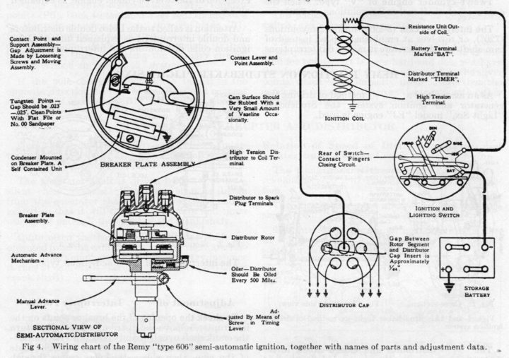

Just for reference, here are some 6 volt systems showing the extra resistance unit built into the coil and thus no extra wires for a bypass. The extra resistance when needed is determined by heat and load.
