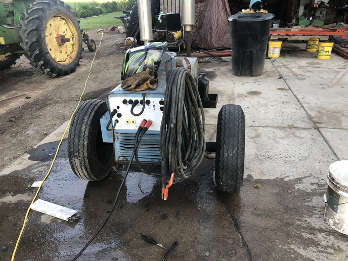

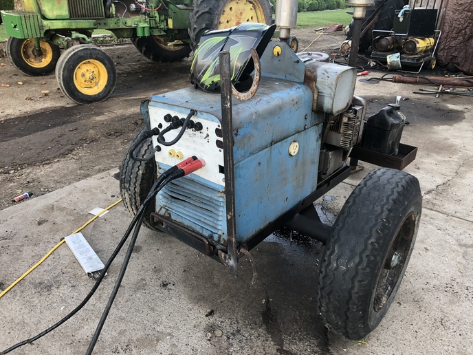

On the welding trailer . Made one lead holder from some old horse shoes I had and a piece of angle Iron that was laying around going to make another for the ground tomorrow got to late tonight

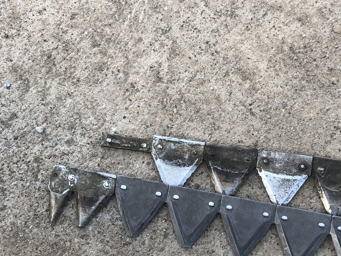

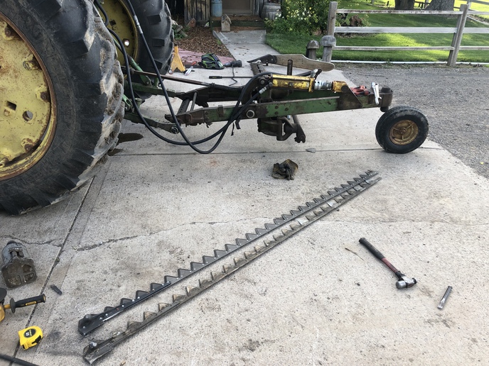

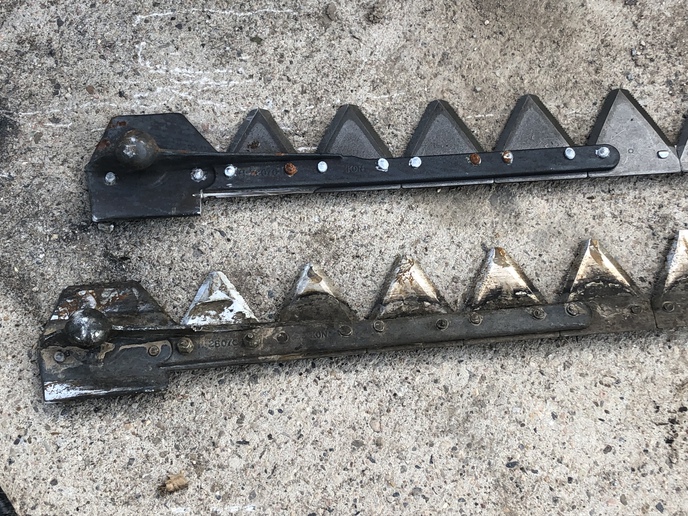

Changed knives in the no.8 mower the other has been In for 30 acres and some ditch mowing and it was pretty trashy ground I�ve got two more fields and another crop of triticale to cut . This winter I�ll change out the sections don�t think I�ll go back with the harvest king brand of sections they just don�t hold up as well as the John Deere ones do
Have to modify the knife head a little on these to make them work so somewhere along the line someone has gotten the wrong spec on it these knives also don�t come with a end section so I swapped that out to should be ready for another 30- acres or so
