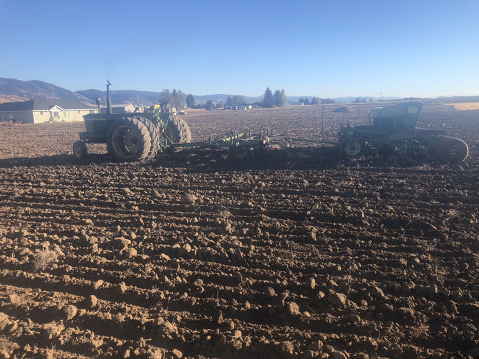

I also pull a chisel plow with 14 inch wheat land sweeps in front a 16 foot set of lz1010 hoe drills I like the hoe drill in trashy conditions because the hoe drill will work through rough trashy ground and get the seed in contact with the soil . I pull it with a 60 drawbar horsepower tractor with duals and we have everything from white clay to clay loam soil
This was a fall planting triticale this spring after all the snow and rain all the clods are gone and the field is smooth as glass .
