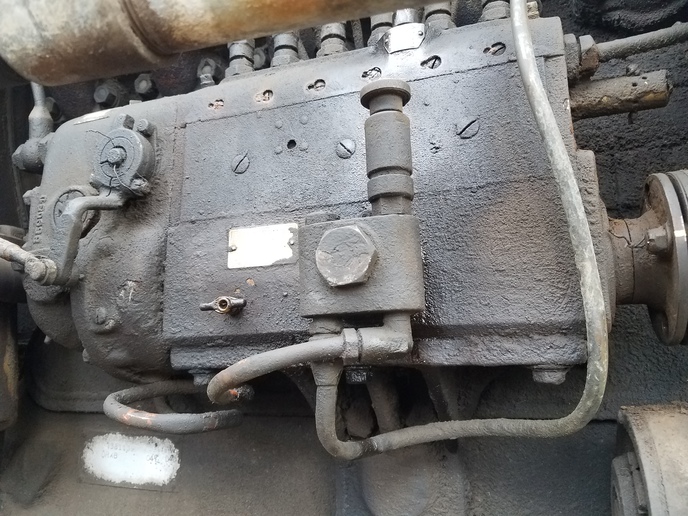

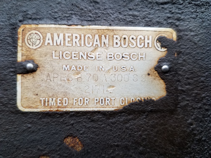

I am working on a mid 30's Hercules diesel. So far as I can tell the injection pump had no oil left in it. (Last ran 30 years ago.) About how much oil does the pump hold? There's what I think is a drain plug under the transfer pump, but I can't get the plug out. Also there is a petcock on the side that I am not sure if it is a drain or level.
I did disconnect the drive coupling, and I can turn the pump over by hand. At least some of the plungers are moving.
