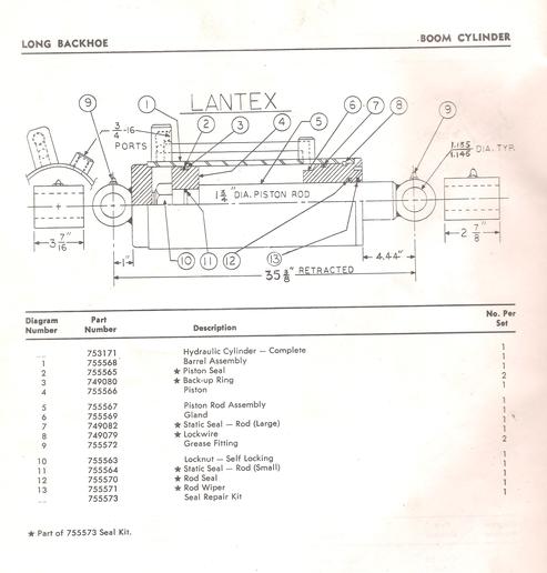

I have had a Long 1199B backhoe for near 40 years for use on the farm. It is in need of main boom cylinder repair . I have a seal kit for it and I have replaced seals in cylinders before so that is no problem for me. Problem is the chromed cylinder rod has some rusting and minor pitting. Inside of tube could also have pitting from water seeping by rod seals and pooling in lower end of tube. I recently stopped at a hydraulic repair business and asked about possibility of having new rod and tube made should they both be so damaged as to be unusable. Guy said it would be expensive, more so than a new cylinder. He had no knowlegce of Lantex brand cylinders used on the Long backhoe but said to bring it in for examination and if replacement is best option he could match up a comparable cylinder from his source's catalogs. I'll get the thing off soon and find out what I need to do.

Attached below are two pages from parts book. I can make you paper copies of parts book. E-mail is available to you in reply button.
