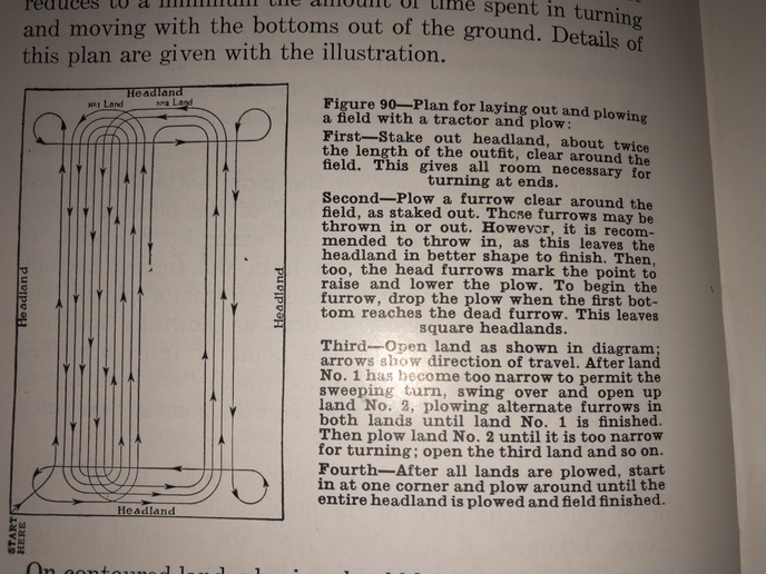

Plowing in lands
Posted by SVcummins on May 02, 2019 at 21:47:54 from (65.129.154.92):
On 80 acres I would cut out about 6 lands
