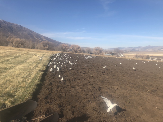

If you�re not rolling it all the war over you might try leveling the plow if it won�t go in you�ll have to drop the point . If you Are 9 inches deep your going to deep need to be about 6 . I love plowing stubble or even old alfalfa stands because you can really make a pretty job of plowing
