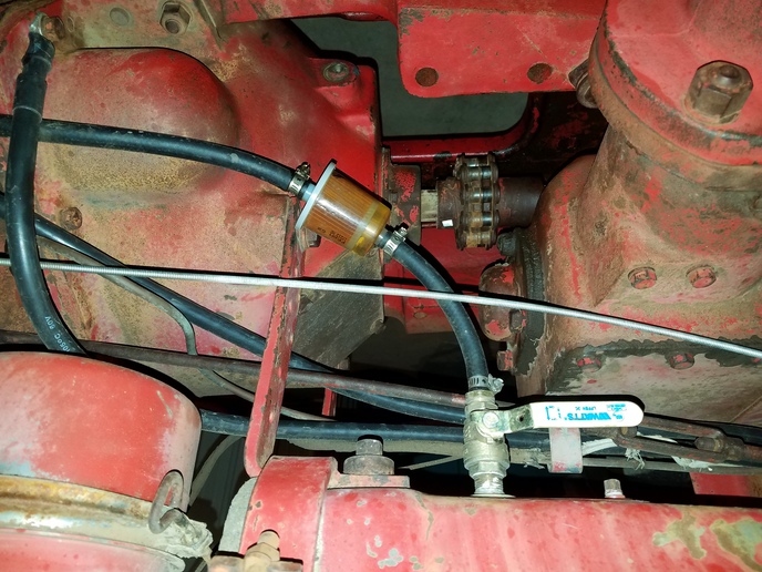

I have given up on sediment bowls. I replace them with a 3/8 ball valve on the tank, and a Fram G2 in-line filter.
