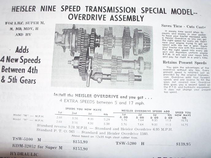

Re: 1942 Farmall M High/Low Range Option?
Posted by D Slater on March 31, 2019 at 18:56:58 from (184.14.152.145):
In Reply to: 1942 Farmall M High/Low Range Option? posted by Northwoods42Fan on March 31, 2019 at 17:49:52:
Never saw one with range controlled on the upper shaft. Picture of a heisler setup with range shifting on the counter shaft. M&W range shift is on the countershaft also. Only thing I remember running top shaft is a gear box bolting to the belt pulley gear box opening. Ones located there I know of didn't change all the speeds you posted.
