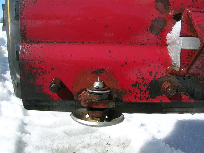

Posted by Russ from MN on March 24, 2019 at 06:30:54 from (69.9.234.145):
Last winter there was a discussion about shoes for a back blade, this is what I put on ours. I must of found the stainless circles in the scrap dumpster, that's where most of my parts came from! By moving washers around you can change the setting, and being round and allowed to rotate they don't catch on obstructions very often. My problem is they are starting to wear through, and I'm not sure where to get some round pieces of steel, the dumpster is gone! I used to grade a couple of miles of gravel road leading to some remote property we own.
