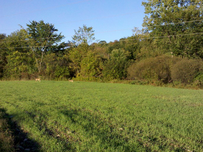

Photo is a stand of oat grass I planted in mid to late August, broadcasting in a rocky section of the field, technically the power company's land.
