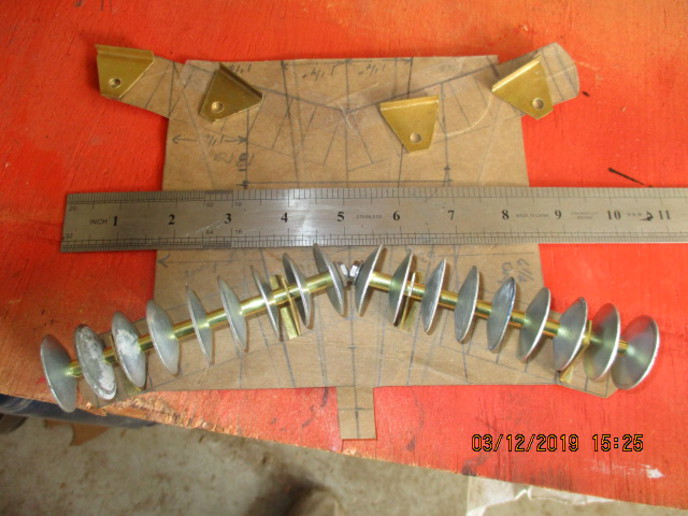

It is a Case 50's vintage model S-139 disc harrow. I got the 2 front gangs built, and some frame members cut.Ended up having to order more brass angle to finish frame.
Here are some pics of the build process Making conical discs from flat washers. I just use a piece of 1" black iron pipe and a 5/8" carriage bolt and center washers on end of pipe and whack with a hammer. to form the discs.
I use a piece of cardboard to lay out the design and then modify slightly to maximize the brass stock.
Frame pieces and completed gang.
Tomorrow I will hopefully, build the 2 rear gangs and start soldering the frame pieces that I have cut, together.
