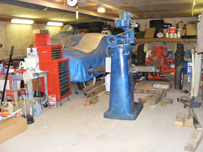

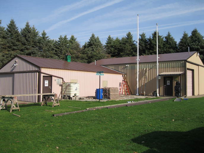

Other than NEVER being big enough, beg, borrow or steal a way to put the cement in during construction. You will not like working on a dirt floor and digging it out after the fact is expensive and a pain. For a 40x60 floor your looking at 45 yds of concrete 6" thick. At $120 per, $5,400. You and 3 friends could put that down in two days. Do all the prep work and forming yourself. Finishing is easy. Just use a bull float, 3' steel trowel and a broom. More than good enough for a barn. That's how I did these 2. The small one was done 10 years after erection, so I do have experience on the wrong way. Believe me, If I can do it, anybody can.
