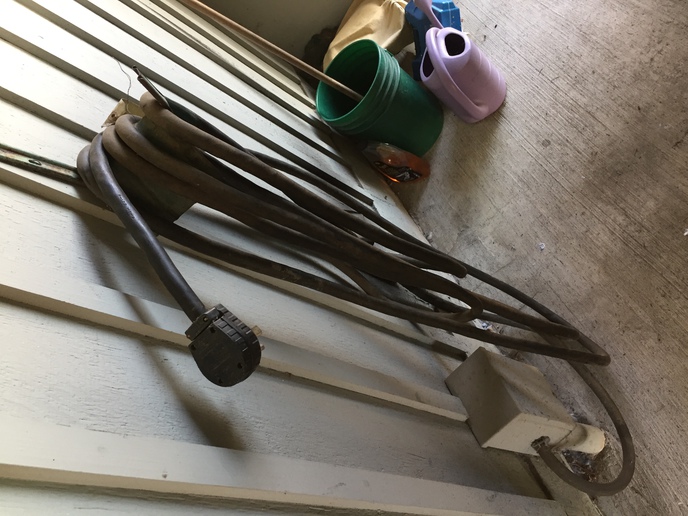

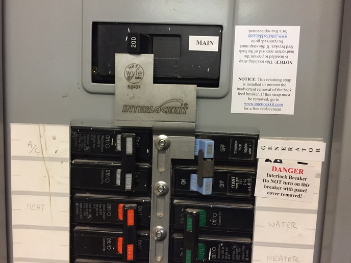

Here�s how the electrician set mine up. The main breaker has to physically be turned off because or you can turn on the breaker from the generator.
