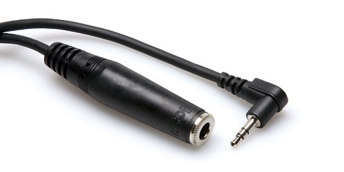

third party image
Here is one on Amazon, the description is wrong but the picture is right. http://www.amazon.com/Hosa-MHE100-5-Headphone-Adapter-Extension/dp/B000068O6B/ref=sr_1_21?s=electronics&ie=UTF8&qid=1417879225&sr=1-21&keywords=3.5mm+to+1+4
Be sure to get one that has a cable on it, not a one piece one. The weight of the large plug and cable on the small jack will eventually cause problems with the jack. That information is form an old geezer that spent most of his life maintaining electronic equipment.
