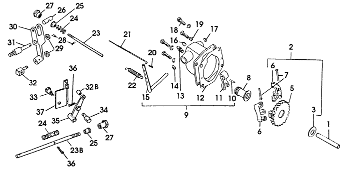

"Every thing on the welder pulled back the skid steer loader pulls forwards."
Brent, I remember you posted about that before.
What I don't understand is that the carb is connected to the GOVERNOR, not the throttle cable or rod coming from the machine.
The throttle cable pulls on a spring that tugs on the governor arm, NOT the carburetor.
So I would think the carb linkages are the same, the difference would be in the lever mounted to
the sheet metal next to the cylinder head valve box area.
I think the area that is different is in the lever, #35 or bellcrank, #30, that tug un the governor spring.
Using the bellcrank vs. the lever would result in the reversing the motion needed to increase engine speed.
Do you have links to the on-line manuals?
If not, see below. There's even a catalog just for the governor options.
