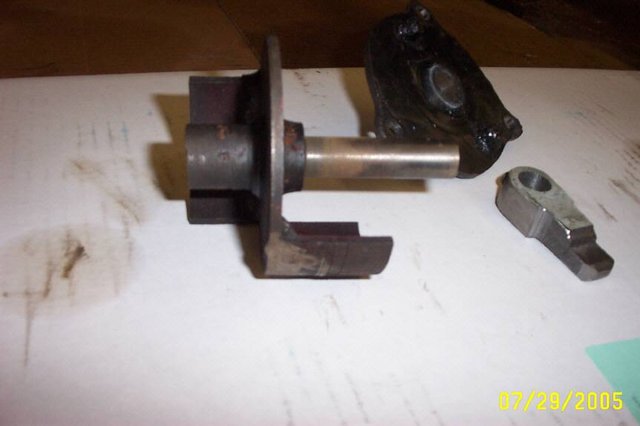

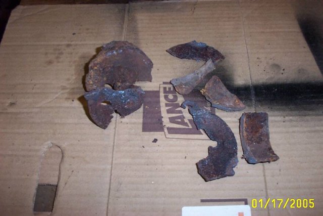

And by the way I still use a torch for many of the jobs. I do quite a lot of cast iron
repair and you WILL do that with a torch if
you want a good repair.Much of the cast repair
that I do is manifold repair. Below is something that you cannot do with a mig .
george
third party image
baffle and cover in pieces
third party image
