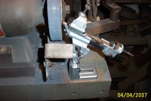

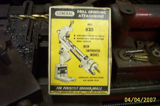

george md
04-04-2007 21:53:38
Report to Moderator
 Re: drill sharpening gauge in reply to MikeCatthemuseum, 04-04-2007 19:04:57
Mike,
A cheap solution to grinding drills up to about an inch is the U S General drill grinding attachment, usually between 10 and 20 bucks and can be made to do drills down to about 1/8 or up to an inch.

Dusty MI
04-05-2007 06:16:20
Report to Moderator
 Re: drill sharpening gauge in reply to george md, 04-04-2007 21:53:38
I have seen this bite holder for sharping bits but I was taught to NEVER to use the side of a grinding wheel.
Dusty
[Log in to Reply]  [No Email]
george md
04-05-2007 10:40:55
Report to Moderator
 Re: drill sharpening gauge in reply to Dusty MI, 04-05-2007 06:16:20
Dusty,
I have a wheel made to use with it that
I put on when I need it . It's cup shaped.
george
