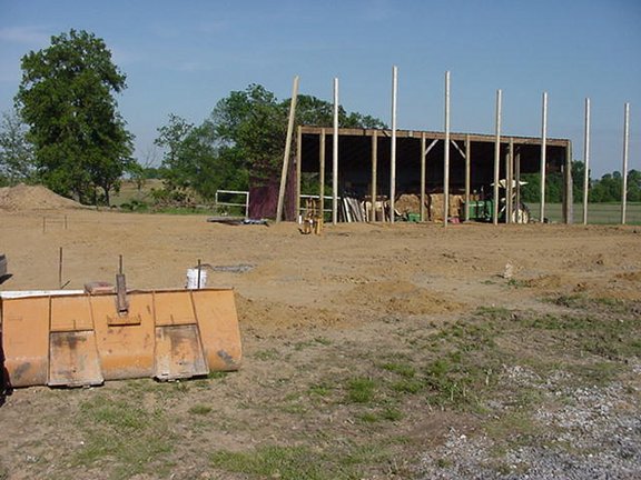

You know I thought the same thing until the other day. I cut through about 10' of some wood and about 50large nails in less than 5 minutes the other day with 1 blade. Yep I was impressed.
