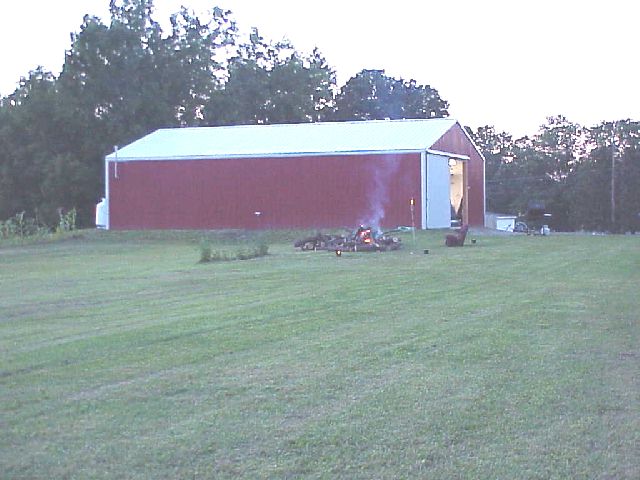

This is a pic of my 30x50x10 pole barn, and I have since added a 50' lean too as well
I built it useing my Makita modle #6095, 9.6 volt drill, This is the cordless drill Makita has made forever, it's cheap in cost and high in quality, batteries charge fast and last, it's light in whieght and has a good "Feel" when useing it.
You can buy this drill with 2 batteries,charger,carrying case and sometimes even a flash light.
third party image
later,dave
