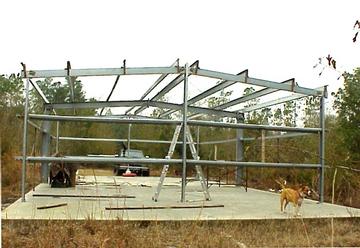

third party image
Hi Doug & (Paul from my previous post to Cody) -
I am nearly finished with a pre-fab steel shop as I type. It is 30x60x14 with 12' clear sidewalls. I subcontracted the concrete work. It is 6" thick with hugh footers, fiber concrete with wire mesh reinforcement, also rebar in the footers. Overkill but according to local code since Hurricane Andrew tore up S. FL.
I will be adding two 10'H x 12W roll up doors. I planned the door height 2' above my backhoe, and width was determined by NOT wanting to back a trailer with equipment into the shop in the dark with no assistance. I felt the extra width was cheap insurance to prevent damage.
This spring I am planning to add either a 20' or 30' lean straight off the shop roof to 10' telephone poles as outside support to maintain backhoe clearance under the lean-to. You can also see the extra 10' of slab - this is provisions for stoop in back to relax with some KY sippin' whiskey (Jim Beam Black) from time to time, fuel storage, and deer cleaning. When?? I don't know!!
Bldg is from Millenium Steel out of Tallahassee, FL. It is a kit and a PITA at that!! In work for nearly 2 yrs. entirely by myself consuming every spare minute I have. Total I have about $13K tied up in the bldg. - that is slab, bldg, doors and incidental costs i.e. fill dirt, extra cables, redheads, consumables etc.
Since I have had mine I would suggest a pre-fab kit but one that has majority of fittings WELDED. Then construction is MUCH easier only having to attach & connect girts and purlins. Steel Building Systems out of Ada, GA makes a dam fine bldg - should I ever get another that is who I'm going with. JMHO!! Butler Bldgs. are nice but out of my price range.
If this is not an option then I would strongly consider a pole barn. But for me price was about the same. Selling point for me was no longer having to waller around in the mud, no termite dmg, minimal weather deterioration (FL = Flat, HOT, Muggy & Buggy)! I had to save a few yrs. to get this bldg. but in the end it will be worth it. I did not want to build a smaller one for fear of having to expand real soon or redo entirely - capital is to scarce around here!!
Anyone can drop me an email if you would like photocopies of my dwgs. or to discuss items to watch out for in a kit building or this entire ADVENTURE!!! Will be glad when this is DONE!!

Looking good ! My slab is scheduled to be poured Tuesday , expect to get my structural steel delivered first part of the week , then work on it as time allows . I finally decided to go weld-up .

Cody -
Thanks and best of luck to ya! I am not a skilled carpenter and as such this shop gave me some fits due to unknown form movement during the pour. Did you got my previous email about slab work?
This is actually an older pic. Haven't taken any in awhile - been to busy finishing. Hoping to finish out roof next weekend. Then it is hang the doors and we are OPEN for business.
